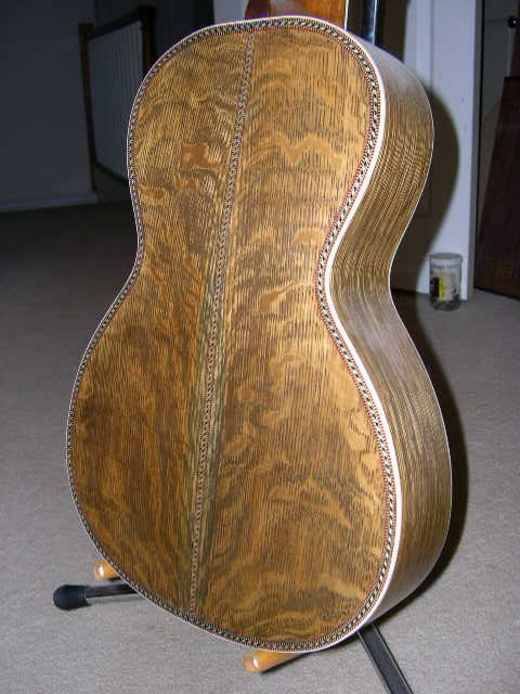

Michael, John How used some curly white oak, uh, Quercus Alba for a lovely small guitar. Maybe he'll post pics again?
Here's a pic of a QA parlor guitar in my possession:
It's not curly, but so well quartered, who cares?
Pretty amazing stuff.
